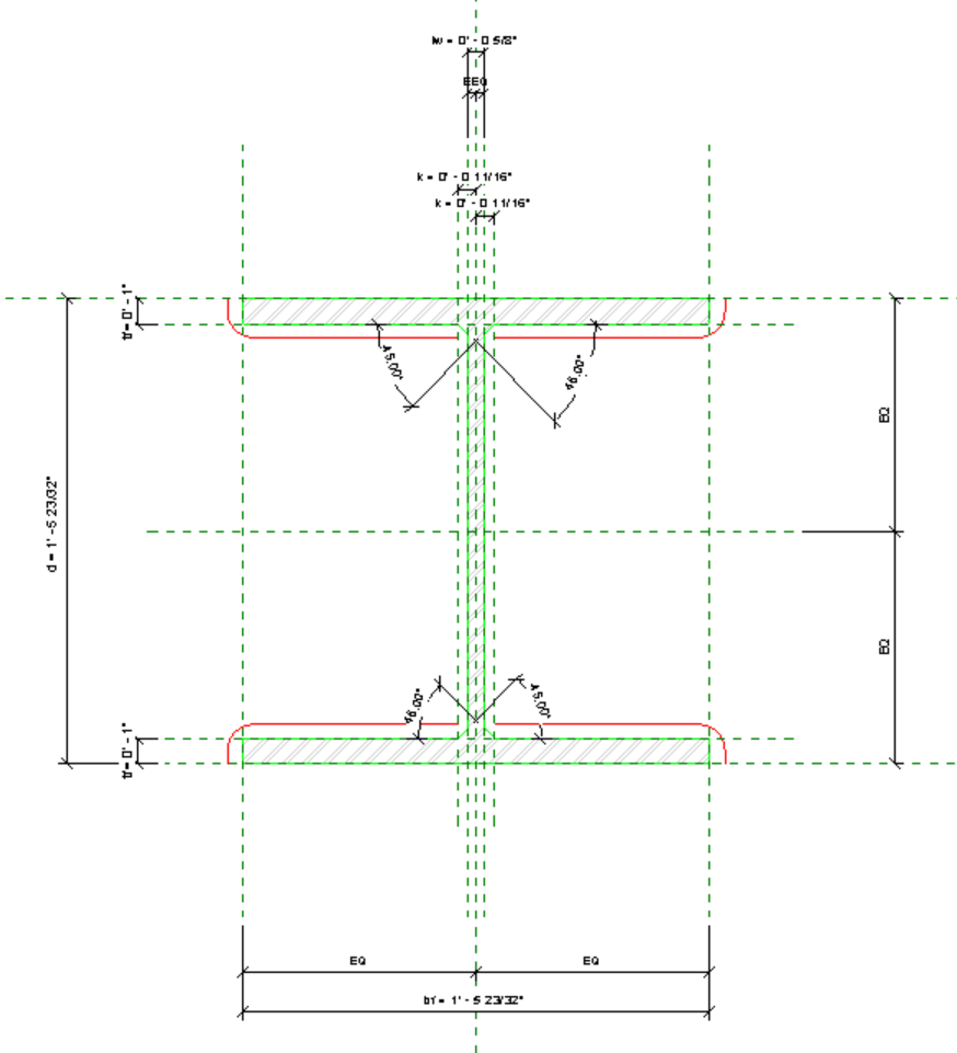

I have been asked to put a detail item together to cope steel beams, and haven't the faintest idea how it works. Does anyone have a (a) family they wouldn't mind sharing or (b) idiot proof directions to put on together?

I believe you are needing to create a 2D Detail Component for beam coping, which would consist of a shear plate and bolts.
It could include flexible parameters for plate size, bolt spacing, etc.
See attached for an example of such a detail.
Revit has a Coping Tool that will cope beams-
Modify Tab>Geometry>Cope
It should be noted that these details are always governed by a licensed structural engineer, so before using it on a real project, consult w/ the engineer of record.

Here is what I think it is - a masking region nested into the W section detail component family, controlled by the beam parameters and yes/no visibility parameters. Does this sound familiar?

- I would use the Coping tool to actually cope the members in projects
- I would not add any detail components in structural families
- There is the structural connection add-in you can explorer if you fancy create 3D connections
- Otherwise, create 2d detail components for connection items and place them in detail/ drafting views.  Open the Details/Metal library folder for examples of such.

The only thing that I have been asked to do is generate a coping detail component to use in 2D details.
A PDF that was given to me mentioned adding the detail components to the W beam (side) detail component - but gives no idea of what the family looks like - plate and bolts, or just a masking region. My gut says to add the masking region(s) in the W beam detail component (section). Which of these sounds well loved and familiar?

So here is what I have. I just added masking regions at strategic locations on the W beam detail component. They can be hidden or not, depending upon the detail. Should do the job - unless something better comes up.....

@Sahay_R: Looks beautiful! But that's not showing a coping condition which is basically a connection detail; how two elements be joined together.
...I just looked at what @cbcarch posted. That's exactly right...unless it's welded.
