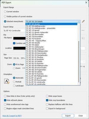

I am looking for a way to batch-export pdf-sets.
I have created a extensive list of pdf-sets through file>export>pdf, 'selected views/sheets'
All floorplans are combined into a single pdf, same goes for ceilingplans, window sheduals, the list goes on.
A tool that can batch export these combined 'pdf-sets', that take over the name of the pdf-set, would be saving me alot of time.
I have looked into DiRoots and PyRevit but both don't seem to be able to split the export in multiple pdf-sets. They can export all pdf's seperatly, rename or combine it into a single pdf. But are not able to batch export by pdf-set.
would be great if someone could help me along with this.

I am using Docuflow, and one can only export 1 PDF set at a time. You would like to batch export all the selected sets? You would export as merged PDFs into a single file with the same name as the set or pre-defined name per set? Whats your requirement?

Yes indeed, I would like to batch export all the 'Selected views/sheets' sets.
So, each exported pdf is a set of mulitple drawings.
And each exported pdf has the name corrosponding to the 'Selected views/sheets'-name.
