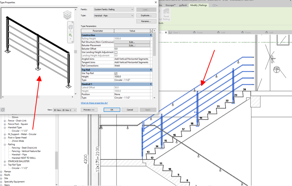

Hi every one,
I've already made railing and set baluster meet top railing and it's looked fine in example preview.
But when I put it in staircase, when I see in Section it doesn't meet top railing, and it look quite weird.
Can anyone help me with this problem ?
Please refer from this picture for more clear information.

Could be that you have to edit the baluster type properties for the selected baluster family (and/or check constraints in the family itself). edit: height parameter that is, if there is one else you'll have to edit the baluster family. Maybe share the file, easier to troubleshoot.

1. Is that a top rail or a handrail?
2. Edit you baluster family and check these:
- Properties: Post box is NOT checked
- Geometry: the baluster itself should go past the sloped reference plane above; a void properly constrained to the plane and cutting the baluster to create the sloped top
3. Copy paste the railing to a new file and share it here.

Just make sure that the Top Cut Angle is higher the your baluster height
