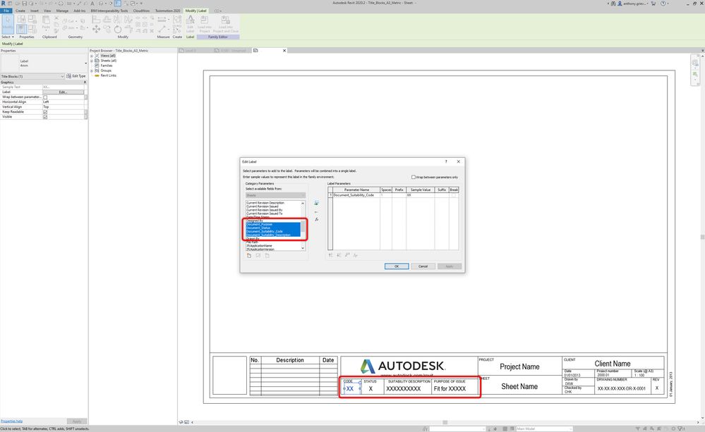

In the Autotdesk Default Titleblock Family, there are four 'Document_XXX' parameters (eg. Document_Purpose). See screenshot.
I cannot see a way to control these within a project?
Beschriftungen (3)
1 ANTWORT 1
Nachricht 2 von 2
als Antwort auf: anthony.grieveson
Export the parameters in the tirleblock family then add them in the project, assign to sheets or project info category, whichever appropriate.
