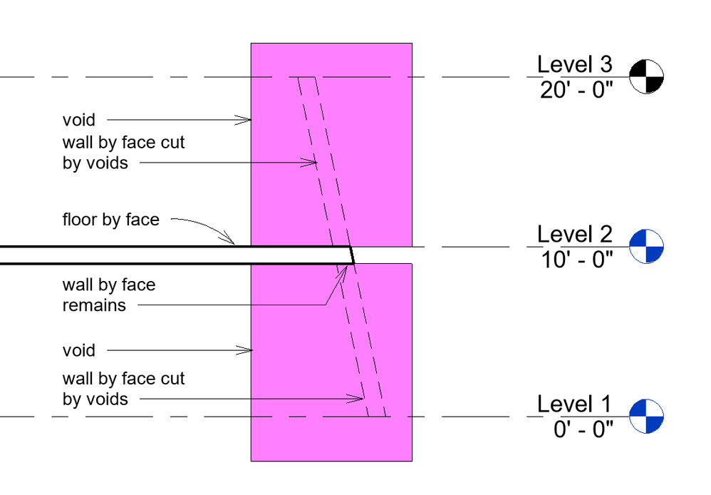

You can create walls by faces and use voids to cut it the the same height as the floor thickness.  Then join the walls to the floor.

This second option seems like a better solution for me, but I don't completely understand.
I take a mass floor, create a horizontal wall by face from it, then create a floor by face in the same position and join them? Where do the voids fit in?

Hope this clears things up.

This is very helpful. I figured out how to cut the walls with the generic void set to the wall cagegory; however, after the cuts are done, I can't seem to join the wall to the floor. Is this a category issue?

I draw the voids as an in place generic model and cut the walls while inside the editing mode. The walls then join with the floor just fine.

Got it working. I was trying to join a wall with angled on two sides with one that is angled on one side.
I think that they both must have the same angles on all edges in order to join properly.
It is strange that it looks like there is two surfaces overlaid on top of one another in both of our 'joined results'.
