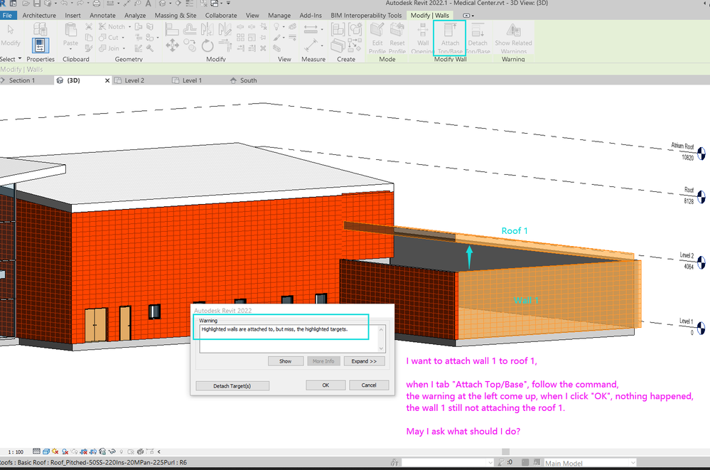

I am using Attach Top/Base command in Revit Architect 2022  and encountering the problem showing in the below screenshot.
Could you please have a look? Thank you.

The wall misses the roof...ie.
  1. either make the roof footprint slightly bigger
  2. Or move the wall to the inside so that it falls under the roof
Make a section and look at it for more clarity

I made some changes according your advise, but there is still a problem.
I explained the details on the screenshot below, could you please have a look? Thank you.

the roof footprint is still not big enough ... look at the image below. Part of the wall is outside the roof so only what is below the roof will be attached
If you want to continue using Attach Top:
  1. Either Align the exterior finish face of the wall with the footprint of the roof
  2. Or make the roof slightly bigger
If the wall does not need to be all under the roof for some reason...then you can
  1. Either attach the wall to a Reference plane instead of the roof (See GIF below)
  2. Or instead of attach, edit the wall's profile to shape it to the roof

I used your second solution, made the roof slightly larger, then the walls attach the roof perfectly! Thank you!
