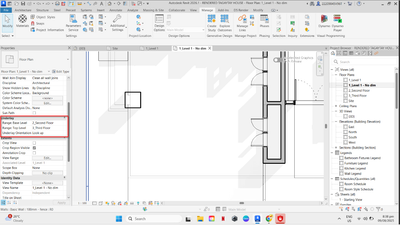

Could you please advise me on how to remove the overlapping walls from the second floor that are appearing as grey lines on the first-floor plan, as shown in the attached photo?Screenshot 2025-08-09 203836.png

azad.Nanva
Set the Range:Base Level to None :
