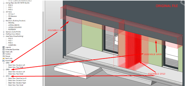

 Those elements where maid as Curtain Walls...Then Assemblie.
This image, the linked file of the original model is already loaded at the Main Project but, i cant creat any assemblies here, and that is my problem.

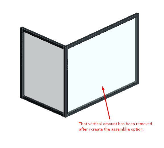

Hi @martijn_pater, i was recreating the assemblies for the curtain walls of the linked files with the Copy/Monitor but the results where not as expected.
The original file with the linked files.
