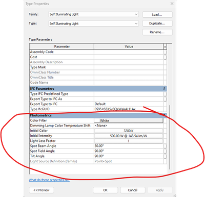

hi every one
i am having issue during rendering of artificial lights in revit and also other rendering software like enscape.i have tried a lot things,search on different platform about it but did not got any salutation regarding this issue . i am sharing my rendering images.

So Enscape will not produce the glow over the lights to look like it's turned on. You need to create a self illuminating material and place it on the light so it glows and looks like there is light coming from it. I've also noticed with Enscape that you need to have the light source bumped up a lot in order to see it. I see some shadows in your first rendering, but adding a self illuminating material and bumping up the light source will do wonders.

Post an image of your material settings for the self illuminating material that you are applying to the lights and the light source information.
juliar123
These are typically material options for my self illuminating lights. You can change the intensity by changing the luminance.
These are other settings of the light in the type properties. You'll need to play with these to get them right. I bumped up my initial intensity to 500W for this example. The default is only 9.
