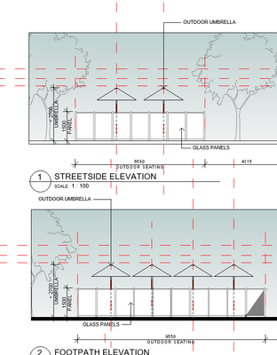

Arrow and text overlapping

Hi, does anyone know why my arrow and text is doing this? I've tried fixing the justification of the arrows and text but its still printing weird. On screen it appears fine.
Image of it being printed:
What it looks like on screen

What font?

Its arial

If you are using Revit 2022 or newer, try to use Export to PDF instead of print to PDF.
If you are using Revit 2021 or older, try to embed fonts under PDF printer preferences.
