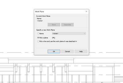

I am trying to array an object and it keeps going in the wrong direction. I want it to array to the right but it keeps going to the left. I have no clue why it keeps doing this. I've tried it on the floor plan and the elevation.
Process:
1) Pick object, array, set options to linear, Number: 5, Move to: Last
2) Pick objects midpoint, Pick reference line which is to the right and it arrays in the wrong direction.
The array is correct but going in the wrong direction. Makes no sense.

Go to Architecture tab > click Set Work Plane on ribbon > what is the active Work Plane that you see?

None.

Can you show a screenshot?  It should be something, not None.

Yes, elevation on that view. Floor Plan says Truss Bearing

Okay change the active work plane for the floor plan to the Level of that floor plan view then do the array again.

It's not giving me an option to pick Level 5.

Are you sure you get the the Work Plan dialog by go to Architecture or Structure tab and click Set button?  Do not select any element when you do the above.  This is to access the View's work plane, not the element's work plane.

That's where I am at. The drop down doesn't give me an option for Level 5.

It appears Truss Bearing is indeed a Level, so your view's work plane is good.  I am not sure what else causes the issue without looking at the file.
