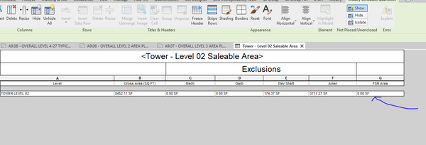

Hi, I've been tasked with creating area schedules to look similar to our excel schedules, having issues laying out the info as per the schedules created in excel. Does anyone know how I can create this type of schedule ? Or is there a better way to do it ?nAt the moment I have just made individual schedules per room (Mech. schedule, Gross Floor schedule etc..)as I am aware It wont look completely like the excel schedules. See attached image for more information on what I am trying to do.

Like this? see attached sample Version 2022 though... this is based on areas and area schedules. Simple:
  1. Uncheck itemize every instance
  2. Sort by Level
  3. I added a Yes/No parameter to sort area types (Included/Excluded)
  4. Add an Area calculated parameters based on the yes/no above
  5. under formatting - calculate totals
If you are not using areas, you can create similar using Roombook/Areabook based on rooms

Thank you so much, this worked perfectly. My only issue is the FSR Area calculated parameter wont work, any reason why ?

If used yes/no parameter for filters ... you need to uncheck all what is not applicable ... a grey tick means neither yes nor no.
Once u uncheck them, it will work
