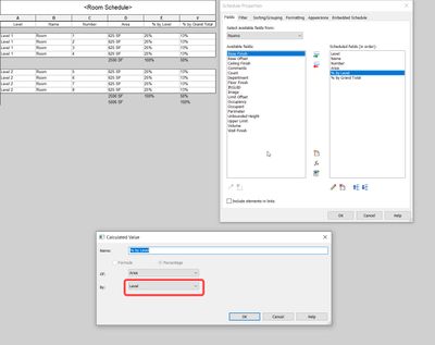

Hi, I am trying to make a schedule of Areas that calculates what percentage an area is of the total building gross area (done), as well as just the percentage of the floor area.  I've got the total building area percentage working with a calculated value field, but I can't seem to get a calculated value that is assigned to a specific level.  Any ideas?  I'll attach an image of the schedule I'm building.  Thank you!

Not sure I'm following. Are you talking about Sorting/Grouping by Levels with Calculated Totals?
Something like this?

The way our local jurisdiction wants to see uses calculated in multi tenant buildings is what percentage of a single floor the tenant space takes up, as well as what percentage of the entire building GSF.  I can figure out how to get the schedule to tell me what percentage of the entire building square footage, but can't figure out how to get it to tell me what percentage of the floor square footage said tenant is on.

What about a Percentage by Level and a Percentage by Grand Total Calculated Parameters?

How did you get it to calculate the percentage by level?

Aaaah, I had something weird going on in my schedule.  It wouldn't let me pick "By Level" in the calculated value until I sorted the schedule by level.  Thank you!
