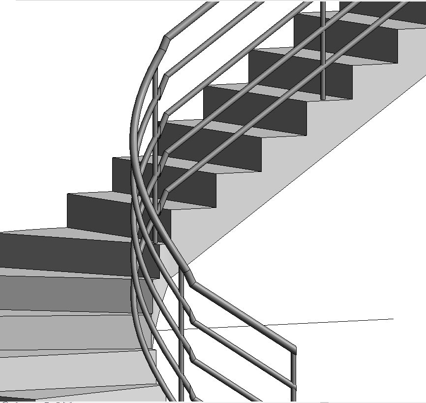

Any way to clean up this jagged railing?

No matter how much I fiddle with the path, nudge it here and there, I just can't get rid of these sharp transitions.

Because the distance between the risers changes around that corner the slope on the railing changes to match. You could create a model in place element for the railing perhaps using a sweep based on the underside of the stair?
