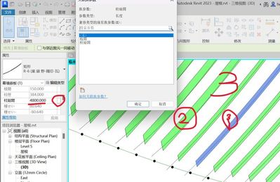

I made a series of roof joist with pattern base families, which has fex paremeters, after make pattern, now have to associate the parameter one by one, any way  to flex and associate then all at one time?

In some cases yes, after the whole in-place pattern model is flex, all the inside pattern elements are identically flex.

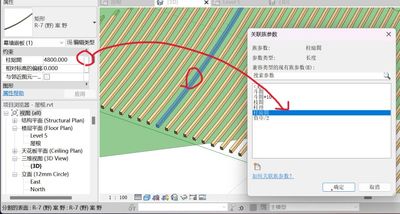

but in the case below, each pattern should be individually associate manually: pattern 2 is manually associated and value is 7800, pattern element 3 has not been associated and value is 4800, both come from pattern family 1
