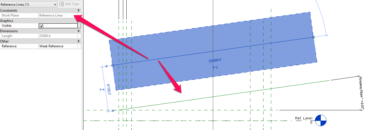

I have been trying for over a day now to add parameters to control reference plane, or reference line angles, and I'm start to go nuts over this. Despite most posts online saying "don't use angular reference planes", I actually got mine to work at first. Problem was that I drew it in the wrong view, so had to re-do it. I have not managed to get it to work again since.
I have tried reference lines instead. They are more stable, but still not satisfactory. I have tried fiddling with the "Weak Reference"/"Strong Reference" settings. This worked initially when I used an actual reference plane instead of a reference line. It has done nothing for me since. Plus, now almost every time I flex the family, the reference lines fly off the screen for no apparent reason, and require me to modify the extents so they're actually visible on the screen, or the family breaks altogether.
I have drawn a reference line which is at an angle to an original, horizontal reference plane. Then I offset a 2nd reference line off the 1st reference line. The two reference lines are parallel to one another. When I assign all the parameters (angle between reference plane and 1st line, and alligned distance between the two reference lines), and flex it, nothing works. I have attached the file.
The parameter which "breaks" the parametric relationships is:
 - Roadway Slope
You can find it in the "Front" view.
After spending quite some time going through all kinds of posts on the internet about this, I have noticed that I am not the first person with these kinds of problems. There are some work-arounds, but few people seem to have a clear idea of what is going on, and when they get it to work eventually, they don't even know how they did it. Solutions to these problems almost never are just a one-post answer, but instead span several pages even. Surely Autodesk ought to improve the stability of working with angles in the family editor?
Overall I will need to have probably up to 15 angular surfaces controlled by angular parameters. Some of these angular parameters will be the "Roadway Slope", but there are also several others. I need to get this to work.

For angles I alway use reference lines. Because reference lines have begin and end point, so can be constrained to a rotation point.
It is also good practice to use the reference line as work plane. Because then other objects follow automatically the angle of the rotation.
For example here the second (top) reference line is autoamtically rotating with the other (bottom) reference line because it uses that bottom reference line as a workplane.
When things get complex, think multiple rotations, then it is good practice to nest elements. Than you can organize one rotation in the nested family and another in the host family.

I actually managed to get this to work for reference planes, but it is pointless since I can only view them from perpendicular view planes.
So I'm using reference lines instead for the inclinined slopes.

The difficulty is that there are two (perpendicular) angles operating at the same time. In general when you have multiple angles in different directions you should start to make use of nested families. In one family you control an angle in one direction in the host family you control the other angle.
In this case I would model the wall differently (if I understand your design correctly).
Use an angle to create the Roadway Camber.and use a swept blend to create the Front Wall Bearing Shelf Inclination.
Both angles can be set to 0°
Attached the concept family in Revit 2016.
