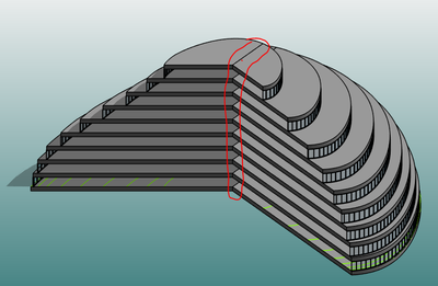

Hi!
I would like to know if I can make the angled cut in the same direction as the image, that it starts with 90º and then deviates to 30º in the same cut, because then I want to orient it to a 3D view and be able to make a diagram (3D cut).
I thank you very much for your attention if you can help.
Corte e ângulo inclinado
Oi!
Eu gostaria de saber se consigo fazer o corte angulado no sentido igual da imagem, que ele começa com 90º e depois desvia para 30º no mesmo corte, pois depois quero orientar ele para vista 3d e poder fazer um diagrama (corte 3D).
Desde já agradeço muito a atenção se puder ajudar.

Oi! Obrigado pela resposta.
Nem na vista 3D eu conseguiria fazer? Porque queria fazer isso em um projeto meu para fazer um diagrama mais artístico.
Obrigado.
Hi! Thanks for the answer.
Not even in 3D view could I do it? Because I wanted to do that in a project of mine to make a more artistic diagram.
Thank you.

You can create 2 3d views from those 2 sections and place them onto the same sheet.

Yes, it isn't for technical insight. I wanted it in the 3D view, because the shape of the construction is this and I wanted a 3D cut passing in the middle for a more artistic diagram.
Similar to this diagram, only following my form.
But thanks

That's an exploded view you are showing.

...actually, it's more like what @bin was talking about.

Not perfect, but worth a try.

The image is just an example. I know how to do it. What I wanted to do was section in 2D with the 90º angle and then turn it to the 30º angle. Then I would go to 3D and orient my view to this created section, to generate the 3D I want. But I think that unfortunately it seems that it is not possible
Revit cannot make this view.

Entendi. Seria isso que eu queria fazer, para depois na vista 3D orientar para esse corte. Porque atualmente a vista 3D só corta em "retângulo", e não no formato que eu queria. Mas muito obrigado pela atenção.

Sorry. In English:
Understand. That would be what I wanted to do, and then, in 3D view, to guide this cut. Because currently the 3D view only cuts in "rectangle", and not in the format I wanted. But thank you very much for your attention.
(see image)
