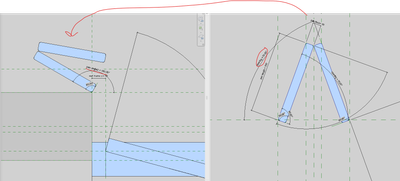

hi, this is what I want:
  • I need to creat a family with a door panel  that rotate on is pivot with a parameter
  • I need also a small panel on the door that rotate on its pivot indipendently
What i did:
  • I created the door panel A
  • I created the small panel B
  • I nested the small panel in the door panel and it works, I can rotate it
  • when I create the family inserting the door panel A+B the small panel doesn't rotate anymore.
I tried other options, but still i don't understand how to have this movement indipendent from each other.
Thanks for helping me!

PaoloGmb
this is what I am trying to achive, but still I have some problems:
I've made the 2 panels in a family with an angle to open and close from 0 to 90 and it works.
The nested family has another angle which control the opening of the two panels together from 0 to 180 and it works, but I need to controll the opening of the two panels, whiwh I can't if the parameter is by instance.
Any suggestion?
