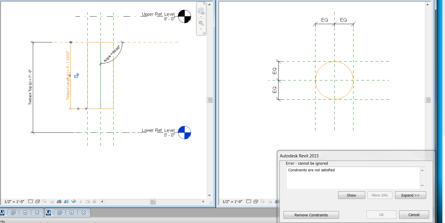

Question: Does anyone know how to successful do an angle parameter from the vertical?
Issue: I cannot get the angle to lock to the shape using a reference line or reference plan. It makes me unconstrain my other successful lenth parameters.
Goal: I am trying to add tiebacks to my Revit project. Refer to the "Column & Tieback" file. For each tieback, I have the Elevation it starts at (y), the angle from the vertical/column (theta), and the length of each tieback (L).
Tieback: Family I started using the "Structural Column Template." I can do the 2 length parameters, but not sure how to do the angle parameter.
Column: The project I am trying to add the tiebacks to.
Column & Tieback: This is what I am trying to accomplish.

Reference planes won't work for angle parameters. Do it with Reference Lines.

rodrigo.bezerra
I would do the shape as a sweep, and constraint the sketched path to the
reference line. Extrusions are complicated to constraint in this case.

RDAOU
@Anonymous
They do but not if they are constraining the reference line. The Length parameter should constrain the tieback/element not ref line...The constraints are not satisfied because of the when you change the angle to rotate Tieback  the length of the reference line will need to change while it is aligned at one end (the center of rotation) and locked.
In your family the ref line can not change its length when it rotates so Constraints not satisfied

Message 12 of 16
RDAOU
@Anonymous
I just fixed what you had the way I understood you post...I'm not sure if this is how you want it to behave
  1. You need first to fix the rotation angle by locking it's (the ref. line) end (center of rotation) to two ref planes - I assumed it is the top
  2. First I unlocked the reference line from whatever you had it locked to
  3. Extend the Center-(front back) ref plane
  4. Lock end of ref line to the Center-(front back) and the horizontal reference plane you had on top (this fixes the center of rotation to that point)
  5. Re-set the Tieback_Length parameter end point to end point of the ref. line (which is the path of the sweep)
  6. re-set Tieback_height from the ref level to the end point of the Reference line (center of rotation end)
  7. I added a radius parameter for the tieback
PS: the naming of parameters shouldn't include ( ) ] [ : shuch characters
Seems to flex ok now...
I wasn't sure what you meant by Length should be dependent on the angle (but to do that you need to triangulate) - from where I see it you have angle B parameter "Angle"...and you need to calculate h= Tieback_Length which I assume would be the hypotenuse based on that angle and where the tieback ties to...To do that you need to know where it ties to (Segment AC = b)
If thats what you need then you need to add another paramete for Tiepoint_Base (Dimension between vertical ref. plane and bottom end of refline) and add formula the Tieback_Base and Tieback_Length
Tieback_Base = Tieback_Top * (sin(Angle) / cos(Angle))
Then
Tieback_Length =  Tieback_Base / sin(Angle)
That should be fairly easy to do now that it flex ok...in this case you just enter the angle and the height
