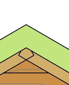

there possibility to allign beams and roof?
And manage the two beams at the ridge on the roof that overlap each others?
.rvt file is attached.
Thank's

You will need to draw the beam longer then draw a reference plan and cut with it.

You do not need a reference plane at the top the Beams join automatically...
Mirror this beam and see what happens :Gesicht_mit_Zunge:

What @RDAOU  should work for you if the right beam system is exactly similar with the left ones but as they are slightly different, you can use the cut tool to cut both the right and the lift beam by the reference plan.
cut>>1st beam>> .ref plan
cut>> 2nd beam>> .ref plan

I undrestand for down side mirroring. Have to mirrow also reference plan with beam system.

Build the cut in the beam family...
Nachricht 16 von 16
als Antwort auf: Anonymous
Mirror the beams and the ref planes altogether. You can group them and mirror.
