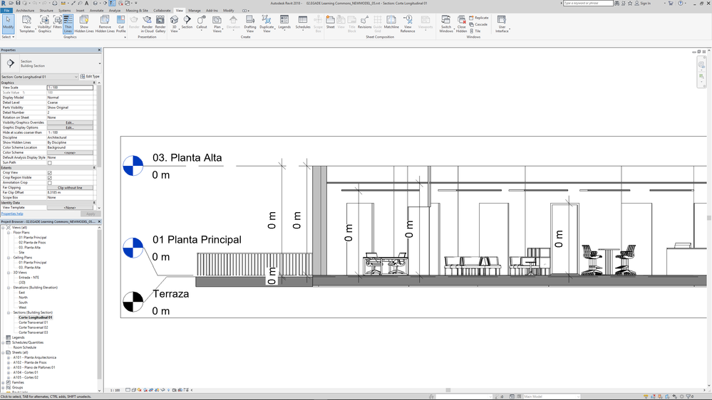

Hi everybody! This is my first project with Revit and for some reason all of my dimensions appear as 0 as well as levels, etc. When I click the text to change the dimension value the real dimension value appears in the box but whatever the value, the text keeps displaying 0. What can I do??? I'm attaching a few pictures. Screenshot (47).pngScreenshot (48).pngScreenshot (49).png
Also, I cannot add spot elevations to my floors!
Thank you

o to project units and decrease rounding.
...or override project units to decrease rounding through the dimension properties.
Rounding Meters to 1000:

hello, try to go to your elevations/sections view > click levels > go to properties > edit type ? change to survey point and see if helps. thanks

That was it!!! Easy as pie! Thank you so much!!
