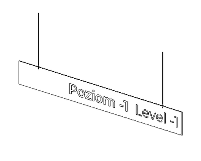

I am trying to create a Revit Family of a parking board hanged under ceiling. The information placed on its surface consists of two texts in different languages - a regular one and bold one - in one line with right aligning. The spacing between the two should have a constant dimension regardless of the text content (and so its width).
I created reference planes to which the texts are aligned and put a dimension between them. However, it does not work, as I am loosing constraints while changing text content.
Can anyone of you spot what is wrong?

I attach an image of how it is supposed to work:
With your help I managed to get a fully working family, but it is up to user where to place the text (depends on Front English Width instance parameter).

By software code it is possible but Revit as is today does not offer the option to determine the length of the text string/word typed...hence, such ref planes will not adapt/react to maintain the offset between the end of the word typed and the edge of the signboard.
The simplest option is to constrain the Margin in between the 2 words and use a parameter to manually control the offset from the edge
I am not at a workstation atm but it might be possible to achieve what you want with using 1 instance (with both English and polish together) in lieu of 1 for English and another for Polish
