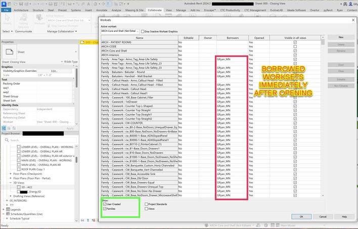

Revit 2024.3 Seems to be having the same issues/errors across different projects,
After upgrading the Revit to 2024.3 users from different projects are getting an error that other users have ownership of a few random families, i have experienced this issue in 3 different project with different pool of users.
All team members are up to date with 2024.3

GRyan_MN
This is atypical worksharing behavior.  Users are showing as the borrowers of upwards of 75% of the project families at project open, prior to editing or manually interacting with the project in any manner.
Curious if this is a result of Content Catalog querying the project families to assess which are Unifi/Content Catalog derived and somehow triggering and retaining editing permissions.
This is exclusive to projects edited with 2024.3 and having all project editors on the same 2024.3 build and Content Catalog release does not prevent the issue.
