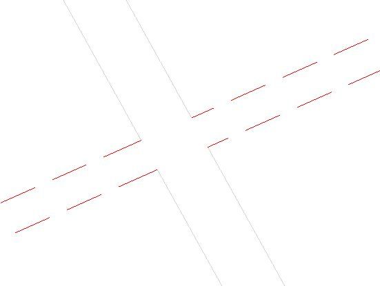

Hey y'all
I'm working in a removals floor plan for pricing purposes and need to display the various cut patterns of walls to indicate the composition of the walls that need to be removed. In our view template we have the phase filter set up to show previous + Demo meaning that EXISTING and DEMOLISHED elements get shown with their respective "override" preset and NEW and TEMPORARY elements are not shown. In the phasing menu under graphic overrides the preset for DEMOLISHED elements there's no graphic override in the CUT PATTERNS Cell (REF image 1). However the floor plan does not display the wall cut patterns like it would if the the phase filter was set to "by Category." shouldn't the cut patterns display if there is no graphic override, or what am I missing? we are using REVIT2017.
thanks,
image 1.jpgPC

@Anonymous
When you set a Phase to Overridden under Phase Filter tab, but actually not overriding its under Graphic Overrides tab, it uses the Phase's material, not the wall's material or coarse scale cut pattern.

Existing and Demolished walls do not show patterns - only New Construction will.
If you want to see a pattern in Existing and Demolished walls - you will need to override the Cut Pattern.

@ToanDN how interesting. thank you. @Sahay_R yes, my problem with that method is that it'll apply the pattern override to all demolished walls and not just the masonry walls. Fortunately there are not many none-masonry walls so I think I'll apply a filter override as you mention and then manually do an element graphic override of the none-masonry walls to hide the pattern. This just means we'll have to keep track of what walls got manually overriden, but like I said, there are not too many of those so it should be fine. thanks!

I've been running into this problem (using 2018) and I've solved it by turning the visibility of the existing patterns "on" and deleting the material for existing in the graphic overrides panel altogether.

This is such a crucial find!  Thank you.   You can then use "Halftone" under Existing Overrides to still allow a difference for Existing Stuff.  And halftone can be adjusted under the Manage>Settings tab.
Now we can clearly show concrete/masonry vs wood walls in our demolition plan.
