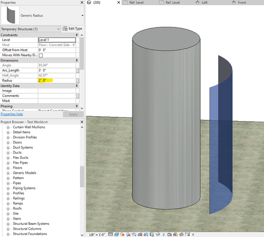

I am currently trying to create an adjustable arc that has a locked arc length with an adjustable chord length. I found some examples on here and YouTube for doing this based off of radius, but I just can't seem to figure out how to do it with chord length.
YouTube tutorial  : https://www.youtube.com/watch?v=7deBFOuH0lM&t=414s
-This was very useful knowledge, but I could not get the formulas to work when trying to make a cord length formula. I would always end up making a circular chain of references.
Revit Forums: https://forums.autodesk.com/t5/revit-architecture-forum/control-radius-on-adaptative-family/td-p/103...
-Same issues as the YouTube tutorial but it was still useful knowledge
This is my current example that is based off of radius
How it is being used in a project
I change the radius to 1' and then line it up to the column
Although using the radius works for now, my end goal is to make this but you are adjusting the chord length of an arc instead. I have found ways to do this, but none of them are able to keep the arc length the same and automatically adjust the radius for you.

Yes I did. I actually recreated it so I could mess around with the formulas to get them working for me.
Unfortunately I still run into the same issue. I am wanting the arc length locked to a certain length and have the radius of the arc auto adjust when I change the chord length. For this example I would only be adjusting Width. R would auto adjust while s stays the same

Yes you are correct. Form the picture your provided, I want to be able to change the distance from O to P while L is locked. Say L=3", no matter what distance from O to P is (unless the number is larger than 3" in which case it would error out), L would still be 3". To answer your question on why, that is how my work wants it (if possible). The example given in the post is was only for a basic visual representation and does not fully apply to what we are trying to do. I would provide a better example but this was the only one I had available at this time. I don't know if it is even possible and with my basic knowledge I could not find any way to make it work.

It has been a few weeks since I last worked on this project so sorry in advance if I mess up any terms/formulas! I was getting arc length from the formula: Arc_Length * 180° / (pi() * Radius). When I then tried to add another formula to keep arc length the same when adjusting chord length, it would end up making a circular chain of references and not allow me to proceed further. I tried a few other formulas, but I kept failing at getting it to work. I would post those formulas but I think I ended up deleting that example :leicht_stirnrunzelndes_Gesicht:

Sorry I might have jumped the gun on that one. So this seems to be almost the same as the original I posted. I am trying to get a formula that has a fixed arc length and an adjustable chord that will change the radius to fit the arc length. This is using the radius to change the chord length instead if I am correct.
The blue line (chord length) would be adjusting radius(r) so that Arc Length (L) will stay the same.

The column was only used as an example to give a basic idea of what I needed and show what I had so far. The equation I am looking for needs to have chord length as the input parameter and for radius to automatically update so arc length would stay at a fixed length. If that equation is possible.

Using radius as the input is not exactly wrong. I am trying to make an example of using the radius and another example using chord length. The column was just the best way to test things on. I have the radius on already figured out, but I don't have an formula using chord length. The radius based off of a chord length input (and arc length locked) was asked of me to create if it is possible.
