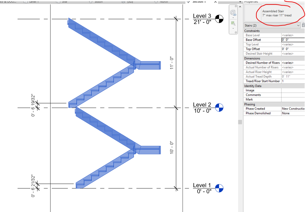

I have a set of stairs which has needs to have a different run for the last run of stairs.  I have created two different stair types for the different riser height for the last run.  I have left the landing associated with the lower run, stair type.  The second stair type starts from that landing and goes up to the roof.  I want to join the top run, stair type, to the landing of the lower run because it shows the stringer on the edge of the landing.  How can I join the landing and have it cut out the stringer at the bottom of that top stair run?  See image attached.
Ideally it would be nice if I could make a U shape stair with the second run having a different riser height but I don't think that is possible?
Also I have tried modifying the support in that area and it will not allow me to change the support type and won't let me slice that one member or adjust the length.
Please advise.  Thanks in advance.

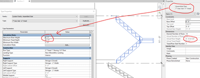

Sure you can. It would be crazy if you need different stair types just because the riser heights are different.

You don't need to adhere to the stair type's default maximum height if one of your stairs needs taller steps.  See below, it is still the same stair type.
Yes they are two stairs obviously because the riser heights are different.  But your question is about stair types, is it not?

Here a landing between two different stairs of the same stair type without any stripping hazard.
And your question is not clear.  You emphasize stair TYPES, which is irrelevant to what your real question is about.

OK.  How do you get a much higher riser height between two stairs of the same type?  Do you specify the "Desired number of Risers" also how do you join the landing with the other stair?
I adjusted the second stair to have less risers, which gave me a warning about exceeding the maximum riser height but I can't seem to join the stair to the landing?

You goal is getting rid of the support stripping hazard then you don't need to join the landing from one stair to the other stair.  Simply edit sketch the landing, split segment where you want no support, finish sketch and delete the support segment there.
