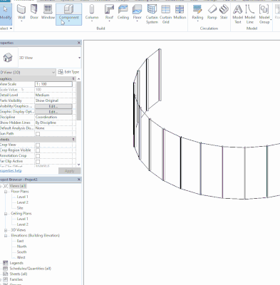

RDAOU
als Antwort auf: l.yong1
@l.yong1
See if the below GIF helps
  • Basic Wall Glass - for the panels
  • Basic Wall Metal - for the horizontal curved mullions
  • Standard curtain wall mullions for the vertical mullions
