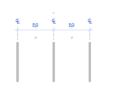

Don't think you can do that in Revit, however, there is a really easy/neat way of centering things while drafting.
All you have to do is draw a dimension string hitting 3 or more objects, and when you select dimension string just click equal, and it will auto center / make everything equal. If you dont want to see the dimension string after just delete it.
