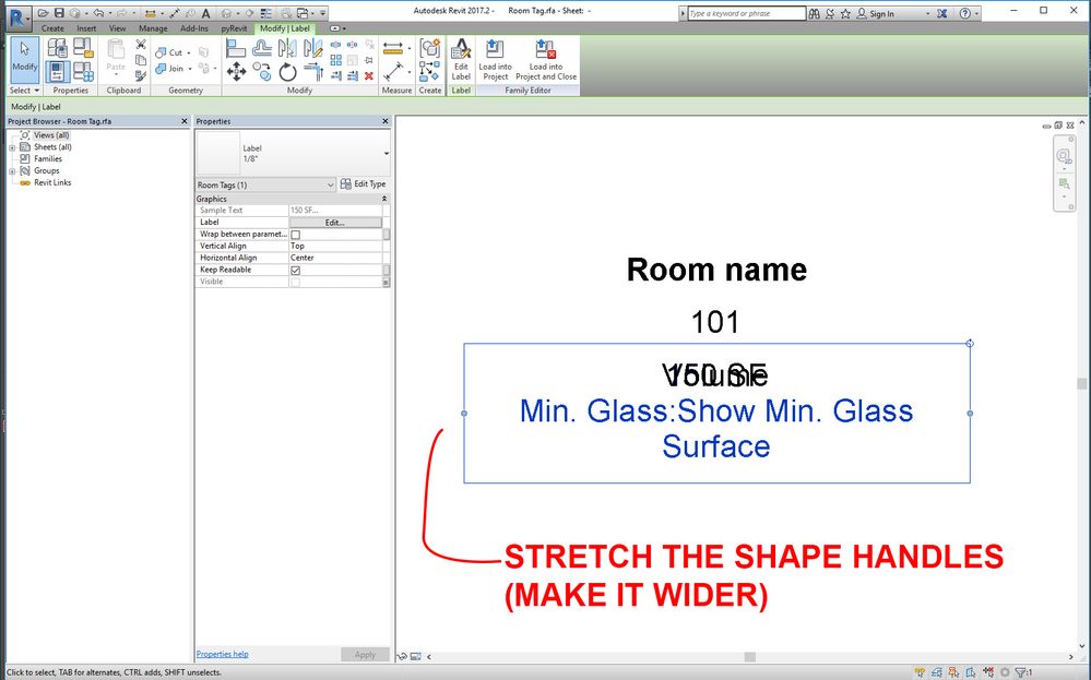

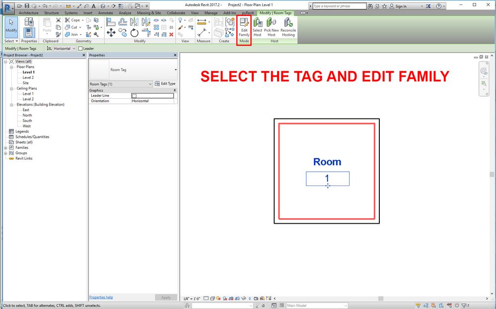

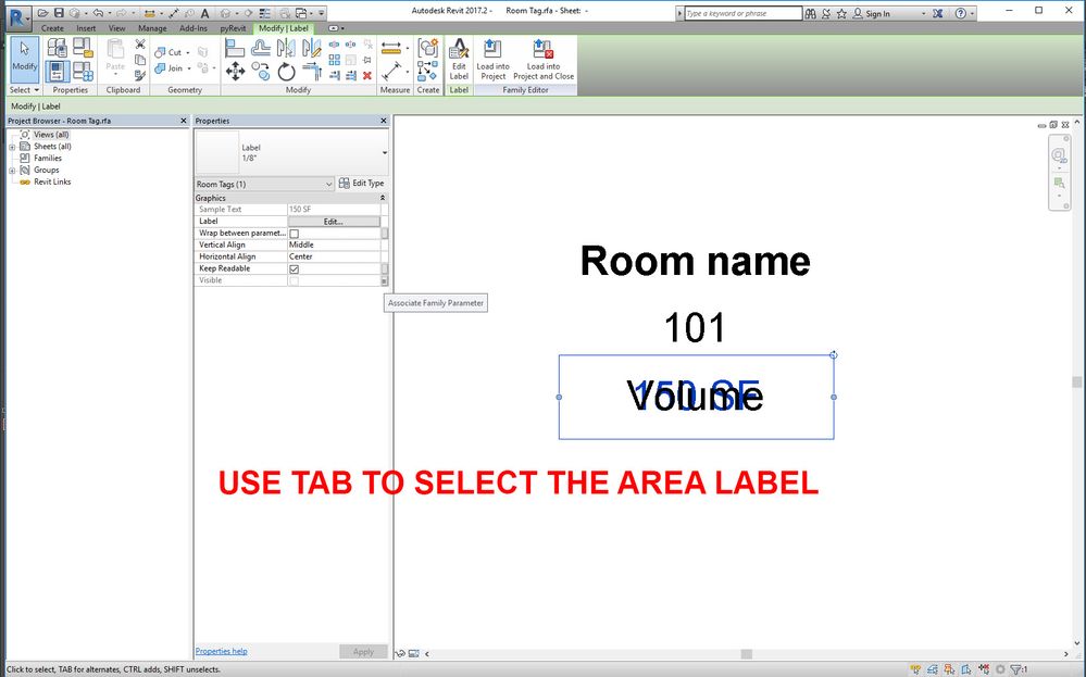

Of course you can do it with a room tag. plaese wathch my screencast:
Nachricht 3 von 3
Ilic.Andrej
als Antwort auf: Anonymous
@zemeraloni created a number parameter which is fine but area would be better. So since I spent some time making these steps, I will show them anyway :leicht_lächelndes_Gesicht:
