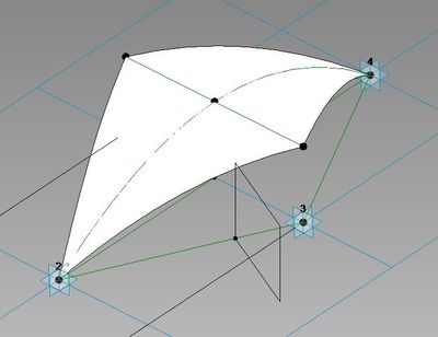

You can make a "Void Sweep" on the flat diamond-shape to cut the corners of the curved rectangle.
  • host a reference point on one of the edges of the flat diamond.
  • host a profile family / draw a rectangle on the reference point.
  • select the lines of the flat diamond and the profile-family / profile rectangle
  • [create form] [Void Form]

my family is a proof of concept family, so it may not function properly. It needs a " symmetrical diamond " to flex .

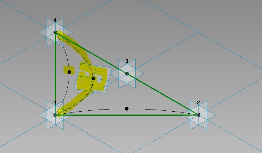

I have attached the Mass I have worked on, modelling panel by panel with voids to cut corners of single curved rectangle. Can it be done in a better and more accurate way?
Nachricht 15 von 19
Alfredo_Medina
als Antwort auf: enji.sorial
1) In a pattern-based template with the rectangular pattern, draw reference points (1, 2, 3, 4 in image 1), then connect these points with reference lines with 3d snapping.
2) Create reference points (a, b, c, d in the image), at the midpoint of each of the reference lines created in the previous step.
3) Create new reference points (e, and f in image 3) hosted on points 1 and 3 respectively. Associate the Offset parameter of points e and f to a parameter that controls the top of the ridge, such as "Offset Top" = 6".
4) Create new reference points (g, h, i, j, in image 4) hosted on points a, b, c, d, respectively. Associate the Offset parameter of points a, b, c, d, to a parameter that controls the intermediate height or middle point of the curve, such as "Offset Intermediate" (positive) or "Offset Intermediate Reverse" (negative). The proportion of this value could be 2/3 of Offset Top.
5) Create a reference line from with 3d snapping from point to point f. This will be the ridge or highest point of the diamond panel.
6) Create 4 Splines through 3 points, one per side, connecting one point on the ground, one intermediate point, and one point at the ridge. For example, Spline: point 4, point g, point e.
7) Create 2 forms, one for each half of the diamond bent panel. Select the ridge, one curve, and another curve, and then use Create Form. Repeat for the other side.
8) In the other family where you want to use this panel, create surfaces, and divide them. The surfaces can be simple curves, or double curvature, or straight. The modules can be square, rectangular, or radial, or following another form. Load the family of the panel, select a surface, and assign the panel to the surface.
9) The panel will adapt to any viable form and division. Then you can load the host family of the divided surfaces into a project.
