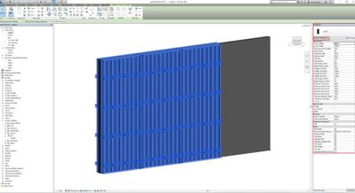

Hi all,
i created an adaptive Family with a lot of formulas running the Family via a few Instance Parameters.
Now i have one problem. I need the Family to be repeated when i load it into a project, but need the flexibility to change every repeated element seperately.
I read in the forum that there is no way like in AutoCAD to explode it like a block in a block, but to be honest that's the thing I'm looking for.
I tried to host my Main Family in a second adaptive Family on a divided Path and linked all parameters to Instance Parameters to control them in the project.
An issue is that i don't have always the same widths but if i change one of the repeated Elements all others are changing too, of course.
For me it's okay to copy the Family to ensure the flexibility of every single one. But it would be a big benefit for those who are planning with the Family i created if they would not have to place every single "Family" manually.
Maybe an adaptive Family is the wrong way to go and you have another option or idea how i could try it or to fix my problem.
I hope that someone has already gained experience with this topic or perhaps has another solution for me.
Thanks in advance and I look forward to possible ideas and solutions and maybe to hearing from some of you soon.

Message 11 of 19
Berger.Simon
That's the family I'm talking about.
I just placed the family on one wall to show it. Normally we have complex structures and shapes.
1. an adaptive family (with nested families) in the project
2. The "single" family copied along the wall
Every Instance (of course) is editable and i can change every single element as i like to.
Just for demonstration. Like its shown in the picture is not common but should be possible.
3. the adaptive family nested in another adaptive family and repeated
I got 4 repeated elements in 1 family. The whole "family" as shown is just placed by two points and repeated along a divided path between the two adaptive placement points.
I could choose one of these 4 and change the parameters, but every single element changes too, because they are just repeated.
