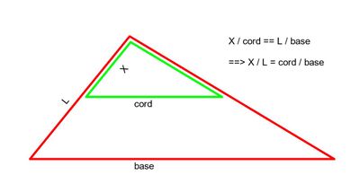

FAIR59
als Antwort auf: Anonymous
you are overcomplicating the problem
  • make a reporting parameter for the base length (total)
  • define cord length with formula: cord = if(Base_Length < 6000 mm, Base_Length, 6000 mm)cord length can't be larger then base length.
  • the ratio from the top is : cord / base (see picture), so ratio from bottom :  1 - ( cord / base)
  • apply ratio to both points of cord.

FAIR59
you can calculate the values for Base_Length_L and Base_Length_R:
  • add reporting parameter for Base_Length .
  • Base_Length_L = (Base_Length ^ 2 + Side_Length_L ^ 2 - Side_Length_R ^ 2) / (2 * Base_Length)
  • Base_Length_R = Base_Length - Base_Length_L
