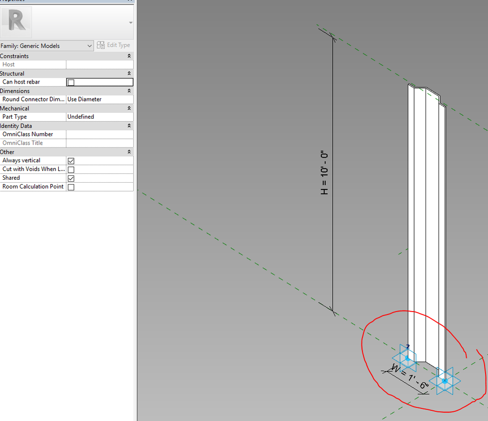

I'm trying to create a sheet pile using an adaptive component but my problem is it won't align with the spline I created. attached herewith is a sample.

I would create the pile family with two adaptive points.

Hi, the spacing of the sheet piles shall be the effective width of the piles e.g. 1.40m
Nachricht 11 von 16
als Antwort auf: Anonymous
Christian - I don't need any reference line. I just snap two adaptive points to two adjacent points on the divided line host to place the first instance then repeat it. The spacing is set by the divided path, which is the same as width of the sheet pile in this case (but not necessary, if I need a gap in between I can have it as well).

See screencast.  I created two adaptive points for the exact reason of keeping the family tangent to the path.

Wow. That seemed unexpectedly easy. I guess when you do the points AFTER the shape, they auto-host themselves TO the corners of the shape? I wasn't expecting that behavior.
