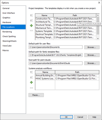

With my Revit 2024 install the Templates are Still there but not pathed you can find them  at C:\ProgramData\Autodesk\RVT 2024\Templates\
You may need to Path them in the Options > File locations > +
You can use an older version of Revit as a guide
