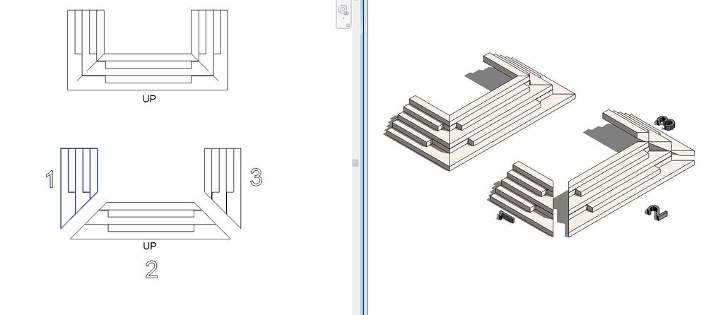

Hi all!
I'm tring to build this type of stair (image 01,02).
Is there a way to build it as one stair (with different steps)? How ?

You will never get it with one stair. Looks like 2 stair types to me. 1 "regular" stair and one that is deep like seats.

Below is what I would do.  A big stair and smaller steps as pieces of floor.
Nachricht 8 von 19
als Antwort auf: TomasoCardia
If Section "Corte A-A" is accurate, I would say that this stair design is not "common".   Just saying.  I think doing it as two stairs is closer to the way it will get constructed in the field.
...actually, I take that back. I like @ToanDN's approach. That's how I'd roll....or "step". Nice job though, @TomasoCardia

Split Stairs in 3 parts..Split Stairs in 3 parts..
All the risers should touch two Boundaries, that constraints the way stairs are modelled..
check this if that helps..

The problem in this solution is that if you want to measure the right m3 of concrete you need, for example, you cannot (or you can do it but not the in the right way - the construction system are different)

Really brilliant solution!

Done!
