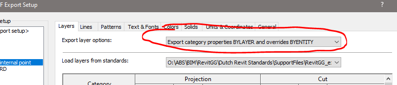

TripleM-Dev.net
als Antwort auf: PEB73
Revit isn't actually drawn in units like AutoCAD does, but it's elements are actual "World" size.
Revit just show/manipulates elements based on the default units set.
For exports to DWG set the correct desired output unit format, Revit adjust it's export on this.
And for visual export settings (Bylayer, keep overrides etc) see below and select the layer option needed.
- Michel
