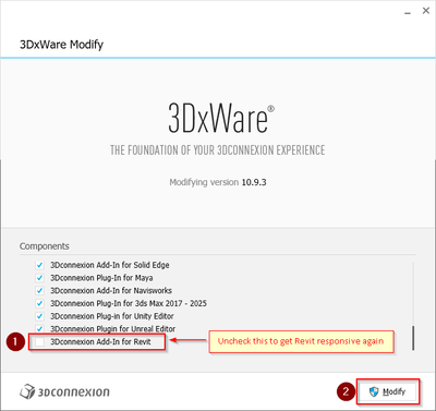

However, disabling 3Dconnexion was not an option for me, since I am also a frequent user of Inventor, where I actually cannot work without the Space Explorer. So, instead of disabling the 3Dconnexion server totally, I changed the installation of 3Dconnexion by unchecking Revit through the 'appwiz.cpl'.
Here are some screenshots to illustrate this:
  1. Windows+R (run) > type 'appwiz.cpl' en press <Enter>
  2. Find '3Dconnexion 3DxWare 10' (in my case) en click 'Change'
  3. Find '3Dconnexion Add-In for Revit' and untick the checkbox. Then click 'Modify' to submit.
  4. I found that there is no reason to restart the laptop, but it never hurts to do so.
Again, thank you very much for posting your solution! Now I can go back to being a happy Revit user 😉
Regards, Peter

I am sorry - I didn't understand what You wrote. You disable the Add-In for Revit while using Revit and then install it again or You uninstall this Addin completely "forever"?
Message 8 of 15
Peter.deVries
Hi @GRZEGORZ_PLECHAWSKI ,
Let me try to explain a bit more about what I meant to say.
J_D__Julander suggested in the first post above to disable 3DxWare in order to have Revit working responsively. And that is a great tip!
Unfortunately, it happens on a daily basis that I am working with both Revit and Inventor simultaneously. And I do want to have SpaceExplorer still working in Inventor. Therefore, disabling 3DxWare is not an option for me. Hence my suggestion to modify the 3DxWare installation by unticking the Revit Add-in.
Hope this helps ...?
Best regards, Peter
