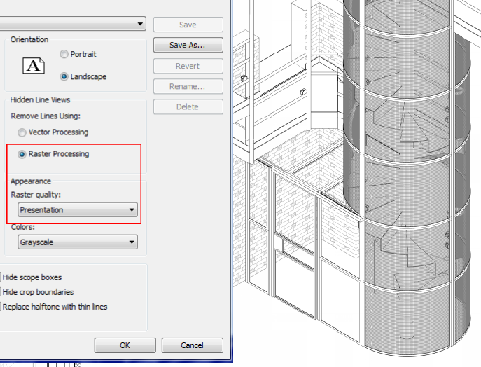

Clearly walls "B & C" is a graphics issue. I'm not sure what type of graphics card you have, but update it with the latest driver from the vendor's website. In regards to plotting them, try adjusting your plot settings by setting Raster Processing & Raster Quality to High.
UPDATE:
If this doesn't work, try adjusting your plotter settings instead by increasing the quality.
If this information was helpful, please consider using the Accept Solution

Updated drivers (NVidia Quadro K2200 fyi).  No effect on the B & C issue.
Tried raster on plotting.  Trippled the PDF size and dropped some of the other panels.

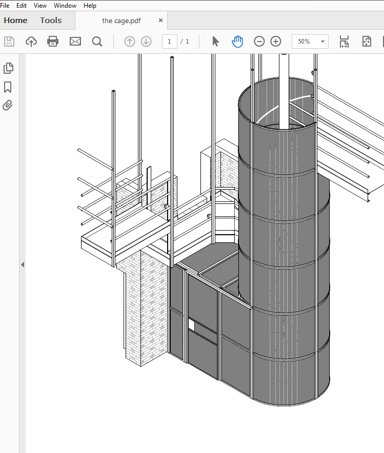

Nachricht 9 von 17
kgatzke
als Antwort auf: loboarch
Our security bot thinks cutepdf is a virus and their executable has unknown publisher so I tried Adobe (we use Bluebeam) on a colleague's machine.
It still dropped some panels.
Notice it didn't render the outline of the spiral stair's handrail either.  I can't even see the handrail's edges on my screen.
The panels render fine in elevation by the way.  I think the problem is Revit is not sending the panels to the printer so it wouldn't matter what pdf printer I used.  I'll still get the same results.
It may have worked for you with cuteftp but remember you're only working with a 3 MB excerpt, not the whole project.   The flat panels in the full model are not visible on my screen no matter how far I try to zoom in to the sheet.  I didn't have this problem with the excerpt probably because it doesn't include the 497 MB of the rest of the project.   I don't know what else I can do besides fake it with some 2D graphics which is going to waste a lot of my time.

loboarch
als Antwort auf: kgatzke
I printed in 2016. Using vector processing I lost panels like you are seeing. Switched to use raster processing and all the panels printed.  I am not sure if someone already suggested raster processing earlier in the thread, but you can try that.

Nachricht 15 von 17
kgatzke
I've come full circle back to the way things were printing when this all started. Thank you.
Nachricht 16 von 17
kgatzke
als Antwort auf: ToanDN
It did this to the whole sheet, even on raster with quality set to high.  I can't imagine this being acceptable to anyone.
