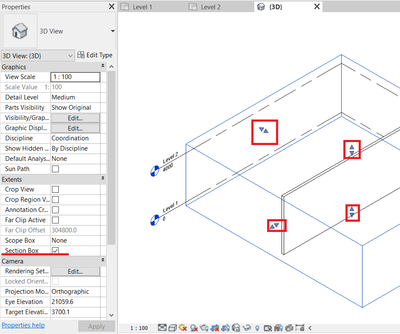

Does anyone know if there is an easy way to set up a 3D Birdseye view of the first floor of a two story home.
Second floor is easy because I can just hide the roof.
Thanks!
875 Views
mauricio_mssf
Select your first floor and type BX or click the selection box icon.
or in the 3D viewing properties, activate your section box and adjust the size.
after that you can hide the section box.

Worked good!
Thank you very much!
