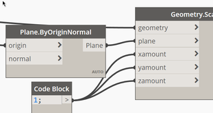

NOTE: If you use an older version of Revit (I think Revit 2021 or 2020)  the objects might be coming out too small
In that case set the scale value to 1 (there was some code change in recent Revit versions)
From:
To:

Thanks for clarifying, for some reason I didn't see the category part of the code. Now i see. I use R2024.1.
I actually had to set the code to " 1". When you re-run the calcs, it places the rooms over the new ones. I assume I have to manually delete the old ones first.

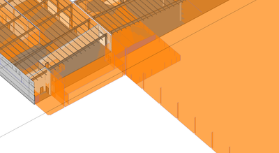

Ok, I opened your project file.
What I did:
-Created a new 3DView and Removed the assigned view template, set view to shaded, set discipline to coordination
-With visibility/graphic overrides, just hid everything with the exception of the site category
You can see in screenshot that I selected one of the rooms, and you can see the name and number in the properties
In the family browser you can see all the created site families.
I can now use normal revit techniques to (temporarily) hide elements, filter them and so on.
When finished I can select them all in the family browser and delete them. Then they will dissapear from the family browser and the model.
Note not to select the "Pad" family, otherwise deletion will not work
You also can do colour/transparency overrides to make things more clear.
In this case also some warnings due to overlapping elements (probably due to running script two times)

I was able to do everything you described. the only part I couldn't accomplish was to set the color-override. I selected a room and applied the below , but it didn't change anything (I just used random colors). I colored everything I could and tried all transparencies to no avail.
Am I doing that part wrong?

As I mentioned. Ther are overlapping warnings in your project.
You changed the colour overrides, however with the two overlapping elements you just see the other one.
Here I moved one of the "room"a little biut to the side. There you see the override colour.
The part that is still overlapping with the other (same) element makes that the colour override is not visible
So remove the duplicates (or remove all the elements and run the script again), then start with your overrides.
