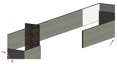

you can click the selection box (BX) from 3d view then go back to the plan and drag the selection box as shown.
