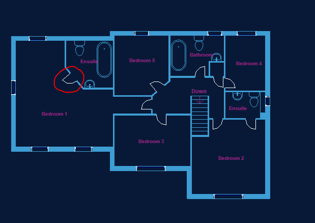

Hello, Im currently creating a Floorplan in 2d view, im struggling to find out how to change the colour of the doors (IN 2D View), can anyone help?
See below, the doors just stay white no matter what settings i change.

You can create new Line style for doors from Manage - Additional Settings - Line Styles - New
or
You can just right click on door and say Override in graphics view by element and assign desired color.
Hope this help you!

edit your door family and change the colour from there. thanks
Nachricht 4 von 4
als Antwort auf: ennujozlagam
Thank you very much
