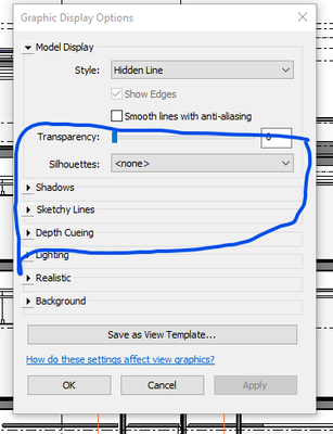

We are running into a single detail view on a sheet with multiple views all with the same view template plotting "half tone". I have attached a screen shot.
Most of the visible elements are detail components and are the same components used in the the other views on the sheet. These elements are a group and I have deleted the group and replaced it as well as removing the view off the sheet and replacing (having had funky graphical problems in the past that this seemed to fix).

- If it is a Section view, set Silhouettes to <none >.
- If it is a Detail view, set the view template to None, change it to a Section view type, set Silhouettes to <none >, change it back to Detail view type, re-apply view template.

Did you go through the second options?  Read through the steps.
Check these as well while you are at it.  Also, turn off NWD coordination model for the view if you have it

Yes I did go through the second set of directions, which is why I mentioned it was a detail view to maybe narrow down other ideas. It was however the fact that Depth Cueing was turned on for some strange reason. We don't really use that for anything, so I'm rather confused why it was on at all.

It happened when the view was created (perhaps accidentally) as a section view with a section view template that has any of the graphic display options enable, then it was changed to a detail view, which omits these options.  The steps I show you is to regain access to those options in order to change / reset them.
