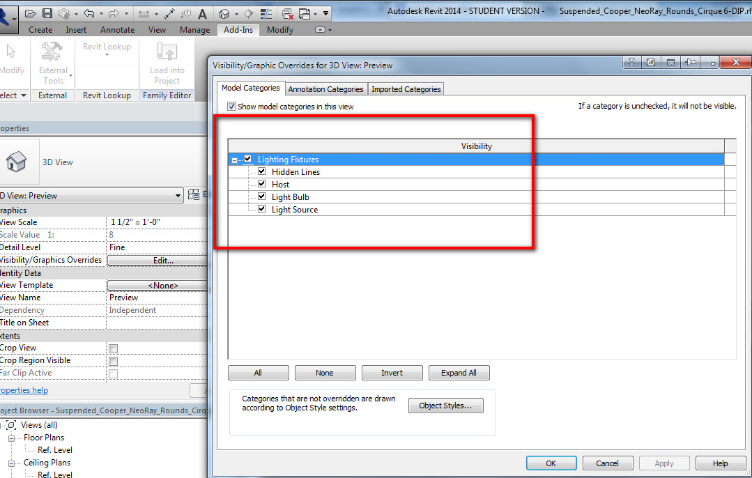

From this post: https://www.revitapp.com/blog/2010/11/hide-or-show-element-in-view/
I see that there are two methods.  If I use view.HideElements method, is there any easy way to access the host box element ID?  I can think of one method: filter all elements and then determine if its category (host as shown in the image) is subcategory of Lighting fixture in order to get the element ID used for view.HideElements method?

Dear Kukuzry,
The hiding has nothing whatsoever to do with how you can or cannot access the host box, whatever that may be.
The categories will help to filter for it, but you will first need to determine which of the possibly thousands of elements you want to filter among.
I have no idea what exactly a "host box" is.
In the case of doors and windows hosted by a wall, each door and window family instance element has a property specifying its host.
That would be the simplest solution.
