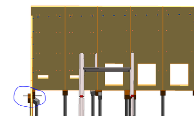

Here are the two target corbels, hosted on these beams:

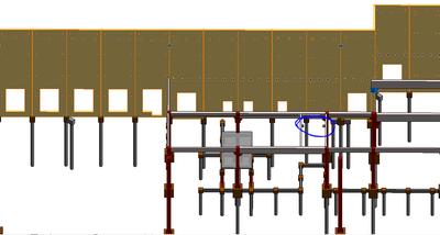

Here is where the family instances are being placed:
Note that the family instances are aligned with the point I am placing them:
