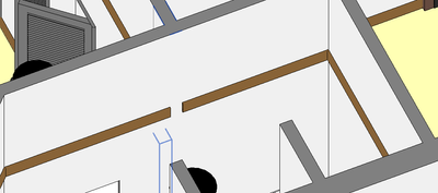

For some reason I need to split some walls at point of T intersection of two walls, so at the end I have 3 separate walls that are creating T. Problem occurs when Revit automatically rejoin those wall and split wall is horizontal.
It works like I want on vertical split walls.
But on horizontal walls, vertical wall splits T walls, and this behavior is unwanted. I would like that it seems that two T walls are one, like Revit is doing with vertical T walls.
My question is how can I control Revit behavior on joining or change it later?

I did some additional experiments and I had some success with changing JoinType and only Miter gives acceptable results, but join is different from join that Revit automatically makes on "vertical" walls (looking at the floor plan). Problem with Miter join is that it makes the join line between T walls visible. Actually I need Butt join but in a different order than Revit makes it on "horizontal" walls.
I will document this with some additional pictures.
This is how Revit joins it automatically (Look at sweeps):
This is with JoinType changed to Miter:
This is my workaround:
