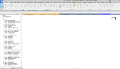

Here's a screen shot with the titlebloc moved away zoom 0,0 and a zoom extent.
