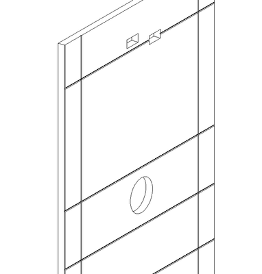

Hey Everyone, I made a script a while ago that took wall geometry and recreated it on the slab for when doing tilt wall layout plans. Looks something like this...
it allows us to easily create layout plans for our total stations.
but there is an issue when i have a round penetration going though the wall. Like this....

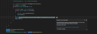

any idea how i can make this work with a cylindrical penetration?
heres the error im getting.

I actually figured this out but not through the api. I modified the family so that it used a sweep of a rectangular profile.
then set the trajectory segmentation to 10 degrees.
this lets the tessellated shape builder create its faces without error.

AGGilliam
I'm assuming the cylinder was originally created by extruding a circle? In that case, the circular face would only have 2 points (2 connected curves) which isn't enough to create a tessellated face. The only workaround I could think of, other than what you've already done, would be to check for when args.Count is 2 and calculate the other various points you want to use for the face then pass that list of points instead. More of an idea than a guaranteed fix really. Although, your solution seems to be working perfectly.
