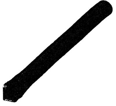

But I don't really like what it looks like:
I'd rather have it look something like this:
Meaning, I want to group triangles into faces so that not every triangle edge is being drawn, but only face boundaries.
I don't expect Revit to auto-detect this, my import data actually provides this information (triangles are grouped into surfaces).
Is there a way I can tell the ShapeBuilder or the Shape to treat triangle groups as one face, instead of treating every single triangle as a face?

MiguelGT17
Hi there, I've faced the same issue. The workaround I went for is to uncheck the show edges box in Graphic display options:
As you can see, now I have a much clearer picture
