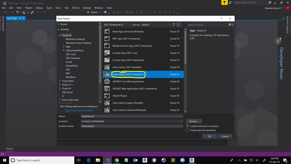

Hi @Hugh_Compton ,
I think while creating the project you have chosen Class Library(.NET STANDARD) instead of Class Library(.NET FRAMEWORK).
As you see, Class Library(.NET FRAMEWORK) helps you to create .dll File which will help us to create Revit plugin.
